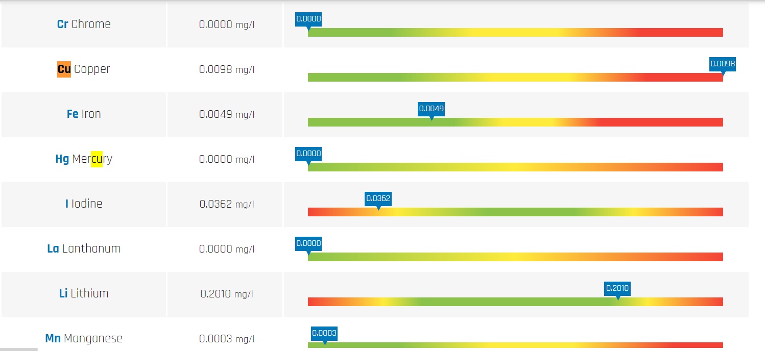

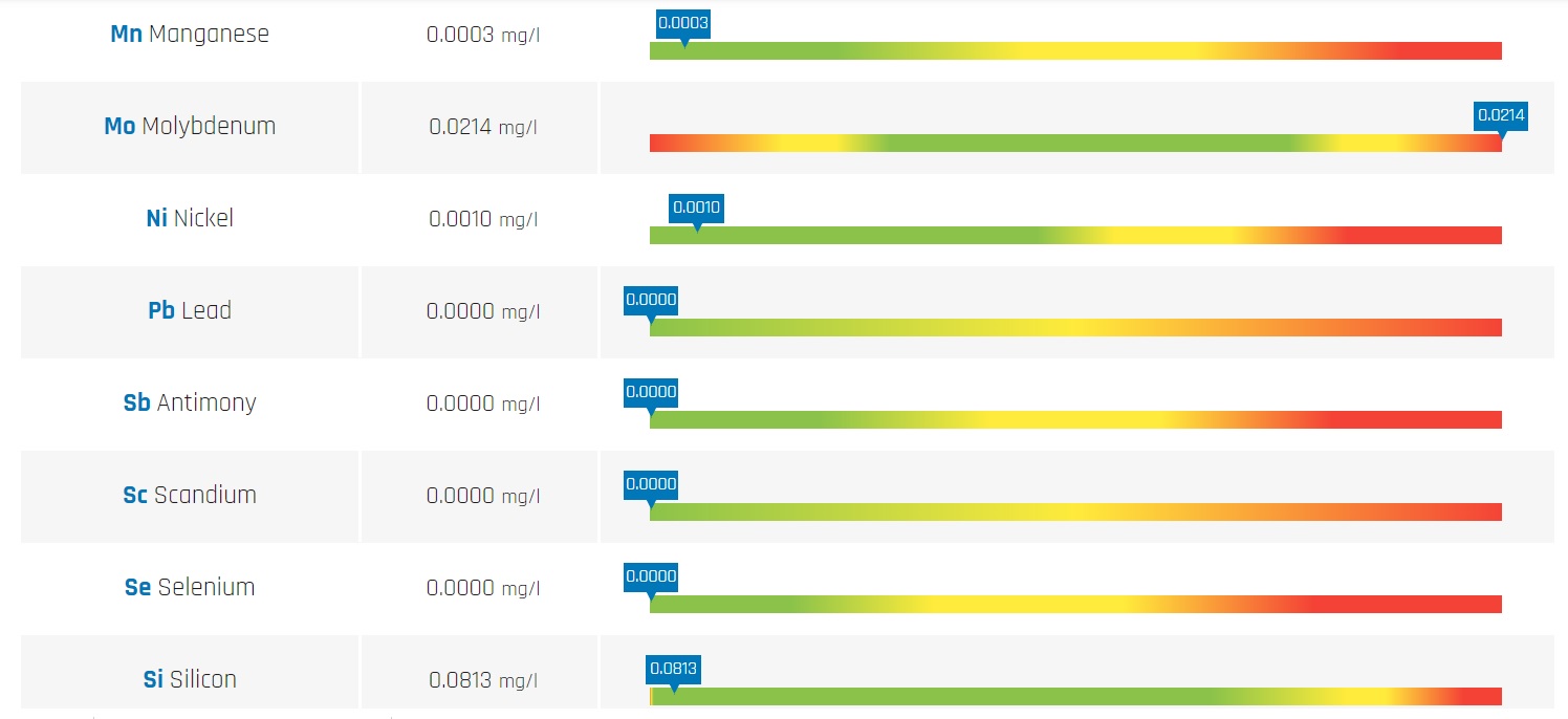

MasterBlaster
Beiträge: 60
Registriert: Montag 13. Mai 2019, 22:09
Re: Basis System Question
Beitrag von MasterBlaster »
Hello tropicreef , Gweny

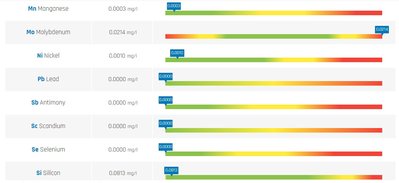

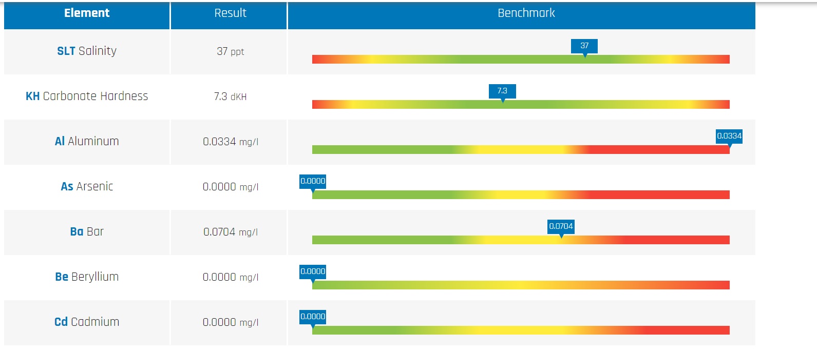

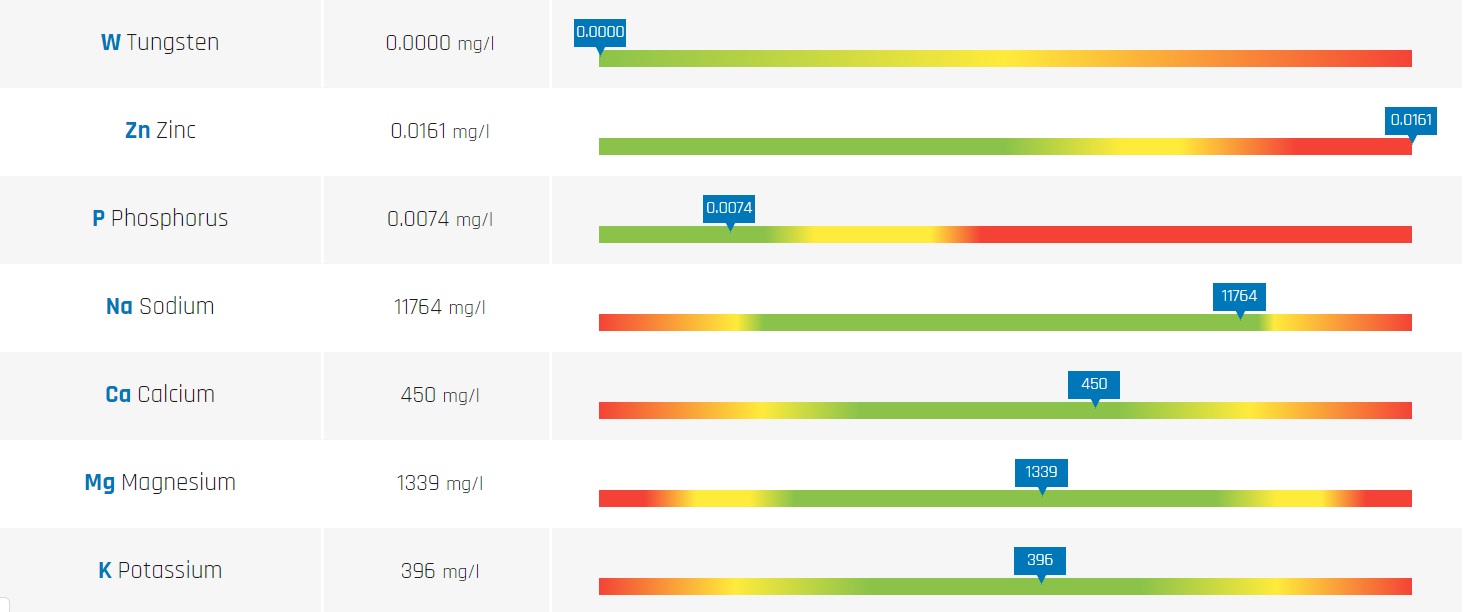

I would really appreciate your feedback as the ICP results have arrived for both tank water and RO water and it is not what I was expecting.Everything looks fine for on the nutrient overdose / ineficient nutrient export system hyposis but I have Al/Zn/Cu and Molybdenum (Mn) in red range. At this point this is a mistery to me as apart from the powerheads/skimmer I only have a metal clamp for the return pump hose and that did not look coroded last time I verified. It was supposed to be salt water safe. The RO water test does not show the red range concentration of Al/Zn/Cu and Mn that the tank water shows.
